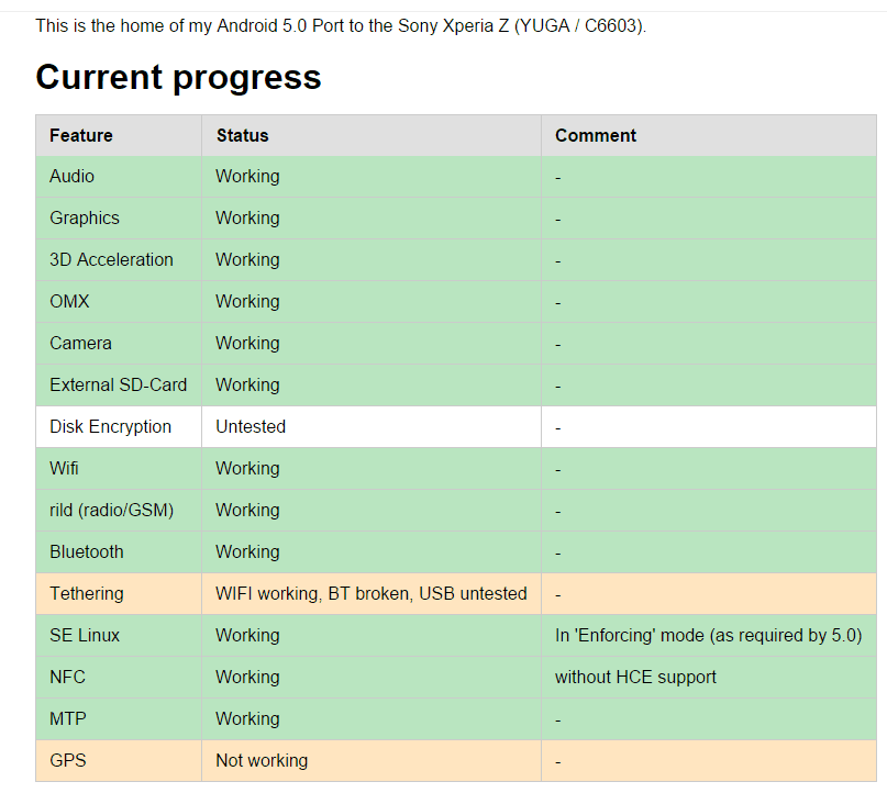

Android 5.0 (L) for Sony Xperia Z (YUGA)
Amost pure AOSP with Kernel 3.4.101
Nighlty vom 09.11.2014
Download
Installation instructions
Download and extract the ZIP image, then flash ALL 3 FILES via:
fastboot flash boot boot.img
fastboot flash system system.img
fastboot flash userdata userdata.img
NOTE: THIS WILL WIPE YOUR PHONE - You are STRONGLY ADVISED to perform a FULL BACKUP!
Also note that upgrading from a 4.4 release is NOT SUPPORTED.
And yes: The release should NOT BE considered stable. This is as experimental as an experimental release can be.
