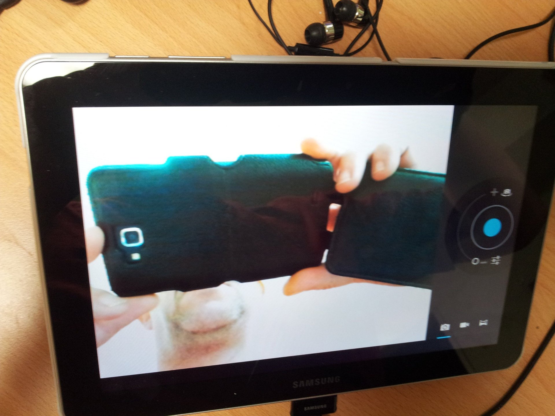

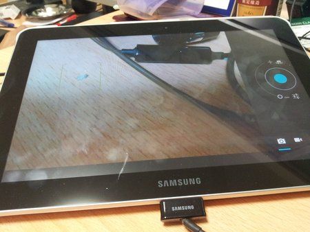

Changes in version 1.00:
  • Update to latest CM sources.
  • Update to 3.1 kernel from Pershoot.
  • Front and rear camera working.
  • Phone might work. No possibility to test for me.

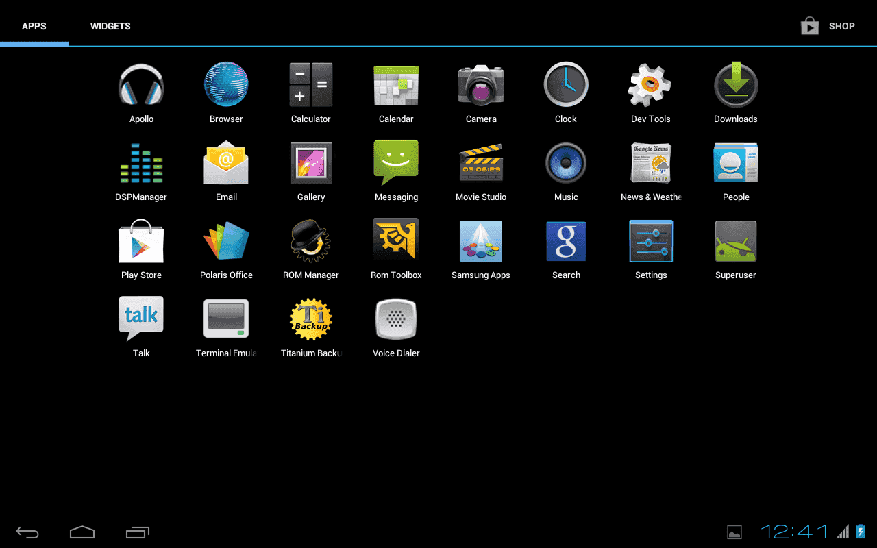

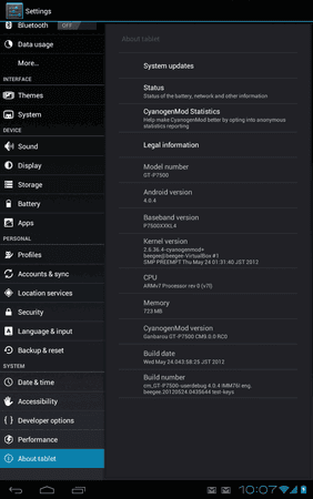

Screenshots:
