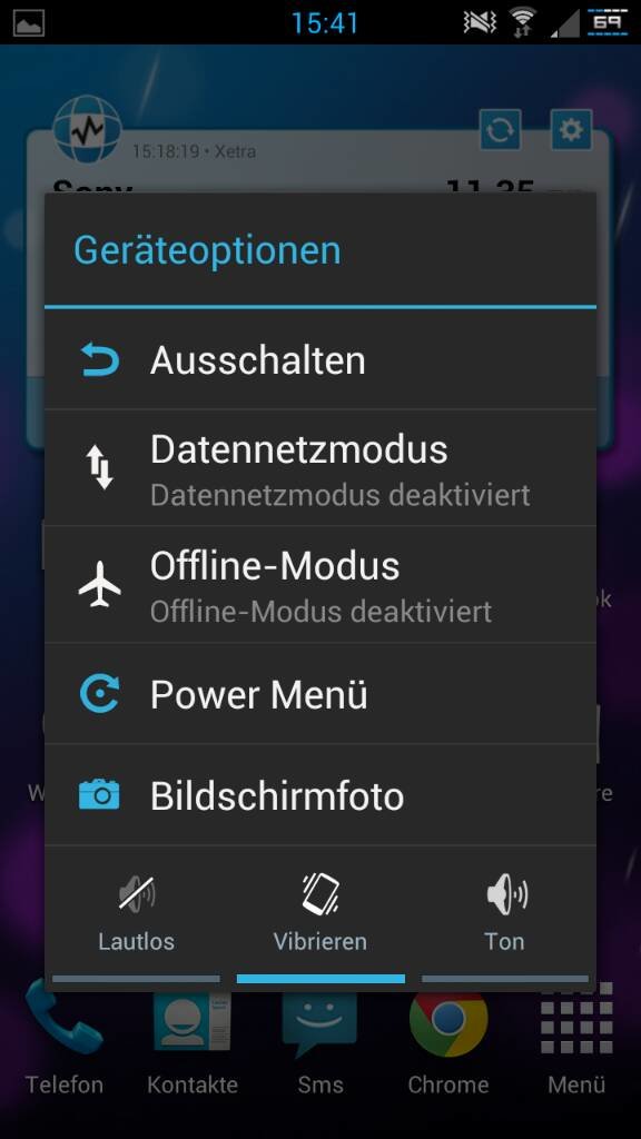

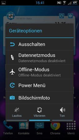

- Powermenü inc Bildschirmfoto

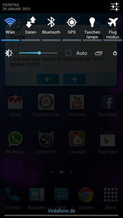

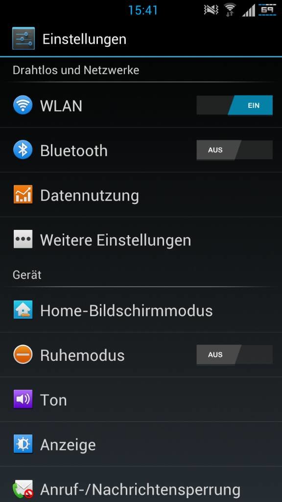

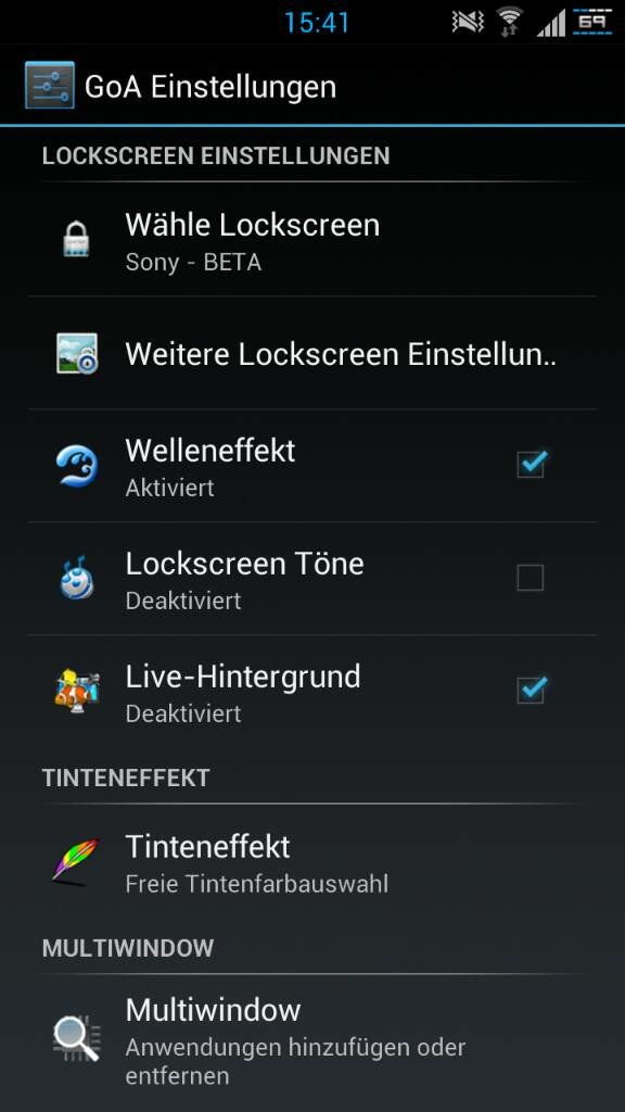

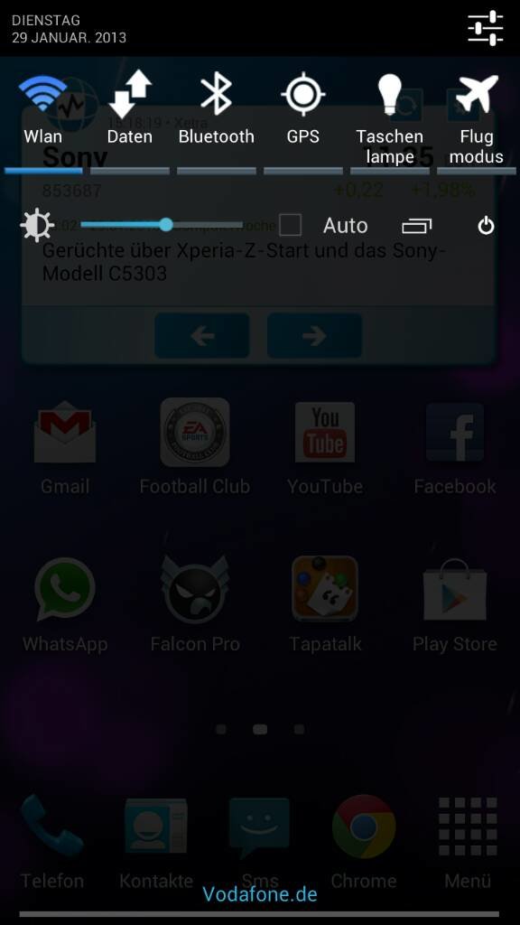

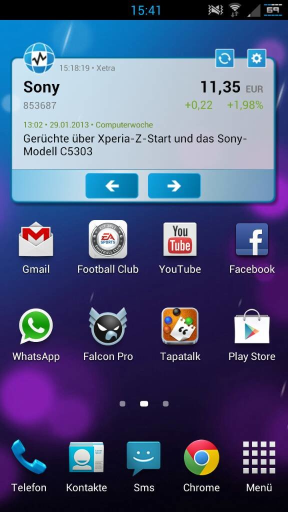

Screenshots
  • 165688d1359470546-sammy-ma1-goatrip-galaxy-siii-jelly-bean-v1-0-uploadfromtaptalk1359470545111.jpg
  • 165689d1359470555-sammy-ma1-goatrip-galaxy-siii-jelly-bean-v1-0-uploadfromtaptalk1359470555134.jpg
  • 165690d1359470568-sammy-ma1-goatrip-galaxy-siii-jelly-bean-v1-0-uploadfromtaptalk1359470565207.jpg
  • 165691d1359470576-sammy-ma1-goatrip-galaxy-siii-jelly-bean-v1-0-uploadfromtaptalk1359470576096.jpg
  • 165692d1359470584-sammy-ma1-goatrip-galaxy-siii-jelly-bean-v1-0-uploadfromtaptalk1359470583603.jpg
