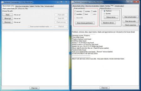

Hi everyone.
This is a tool written in JAVA for easier flashing of the following partitions:
Radio, hboot/spl, recovery, system, boot, userdata and splash.
It can do much more, like:
Erase/wipe multiple or single partitions.
Reboot device either to system or fastboot.
Print of device info.
Flash of signed zip files (E.g. fastboot flash zip myzip.zip) <- Not to be confused with flashing of rom files!
Flash multiple files in one click by using custom folders and tags.
It's basically a GUI over most fastboot commands.
It works for windows, linux and mac.
It has been in use in the magic/sapphire sub-forum under the name RadioSwitcherGUI.
So it's well tested and have more then +700 users.
I changed the interface + added more options to accommodate the Desire device.
But it works for all devices who has fastboot :0)
This should be seen as an extension of the modified hboot files by Alpha-Rev OR the unrevoked forever radio s-off.
If you do not know what they are, this tool is not for you.
Use it at your own risk :0)
Hab ich auch schon getestet. Läuft ohne Probleme.
