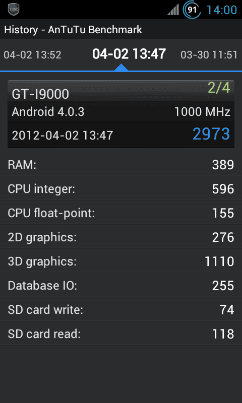

Mit Semaphore ICS 0.9.8s und 1000MHz:
AZmftKyVW0wCAAAAAElFTkSuQmCC

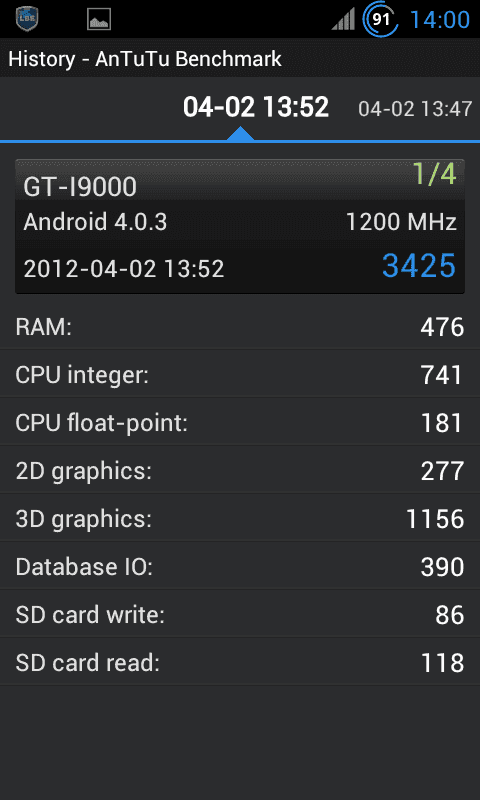

und mit Mit Semaphore ICS 0.9.8s und 1200MHz:
aOjgN6bwUAALccpjgAADiFgAYA4BQCGgCAUwhoAABOIaABADiFgAYA4BQCGgCAUwhoAABOIaABADiFgAYA4BQCGgCAUwhoAABOIaABADiFgAYA4BQCGgCAUwhoAABOIaABADiFgAYA4BQCGgCAUwhoAABOIaABADiFgAYA4BQCGgCAUwhoAABOIaABADiFgAYA4BQCGgCAUwhoAABOIaABADiFgAYA4BQCGgCAUwhoAABOIaABADiFgAYA4BQCGgCAUwhoAABOIaABADiFgAYA4BQCGgCAUwhoAABOIaABADiFgAYA4BQCGgCAUwhoAABOIaABADiFgAYA4BQCGgCAUwhoAABOIaABADiFgAYA4BQCGgCAUwhoAABOIaABADiFgAYA4BQCGgCAUwhoAABOIaABADiFgAYA4BQCGgCAUwhoAABOIaABADiFgAYA4BQCGgCAUwhoAABOIaABADiFgAYA4BQCGgCAUwhoAABOIaABADiFgAYA4BQCGgCAUwhoAABOIaABADiFgAYA4BQCGgCAUwhoAABOIaABADiFgAYA4BQCGgCAUwhoAABOIaABADiFgAYA4BQCGgCAUwhoAABOIaABADiFgAYA4BQCGgCAUwhoAABOIaABADiFgAYA4BQCGgCAUwhoAABOIaABADiFgAYA4BQCGgCAUwhoAABOIaABADiFgAYA4BQCGgCAUwhoAABOIaABADiFgAYA4BQCGgCAUwhoAABOIaABADiFgAYA4BQCGgCAUwhoAABOIaABADiFgAYA4BQCGgCAUwhoAABOIaABADj1fxb5oSmew82iAAAAAElFTkSuQmCC
